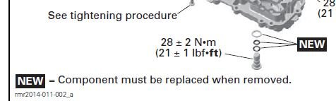

I don't know about miracles and I'm not saying one can't get away with not replacing o-rings, washers and such; I'm just concerned enough about my investment to follow the manufacturer's directions. The snip below is from the service manual and there is a similar notation on the clutch cover plug washer. To each his own.
