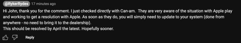

Also got this reply on a YouTube video about the new display and CarPlay...
Quote:
Hi John, thank you for the comment. I just checked directly with Can-am. They are very aware of the situation with Apple play and working to get a resolution with Apple. As soon as they do, you will simply need to update to your system (done from anywhere - no need to bring it to the dealership).
This should be resolved by April the latest. Hopefully sooner.
