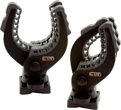

These will hold the top, Koplin Gear Grips, you can get them from Amazon. They are made to hold lawn care tool on the trailer.

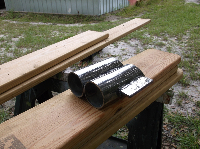

On the bottom I just made a holder from some stainless steel tubing to slip the tips in. Had them on my Harley trike, but they will be going on the Spyder. I don't have a left leg, so the left foot peg mount is open for a place to bolt the crutch holders on.
http://www.tanwater.com/pics/crutchholder20.jpg

When folded the fit nicely in the frunk, or are easily strapped to the trunk rack. The Kolpin grips also work well.

Probably not any use to you, but I have a folding cane that fits in the frunk. Those Kolpin grips look great; I might switch!

Leg rest pad with the rags taped on it is just temporary. Waiting for the jell pads to put on it and then I will cover it with leather. Still need to clean the brackets up and maybe paint them. Made everything metal from stainless steel, so nothing is gonna rust anyway. It works well. Crutches are held securely and don't move around when hitting bumps. Real fast and easy to put them in the holders or take them out. The lower tubes the crutch tips slip in are bolted to the left foot peg mount. I have no left foot, so it is not needed as a foot rest. Top is just a Koplin Clamp supported from behind the passenger handgrip. It just slips over the studs the handgrip is bolted to. Couple of washers and a piece of leather keep it from rattling or moving.
