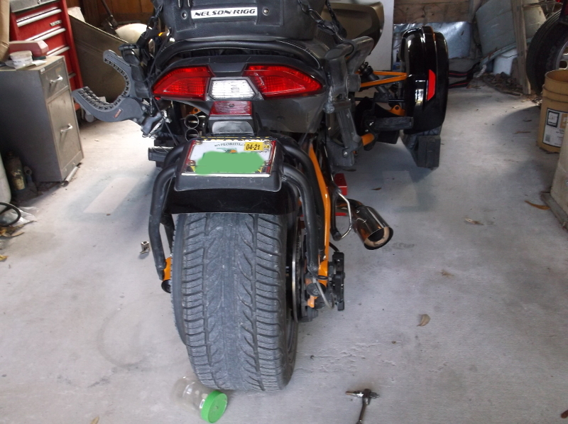

My OEM tire at 8,400 miles........... changed it............
Center wore smooth, outer edges like new.
http://www.tanwater.com/pics/spyder-backtire6035.JPG

That's how mine wore and the dealer told me it was because I had the tire pressure at 29 PSI it was over inflated and caused the premature wear in the middle. He told me if I had the tire at 26 PSI I would have gotten more milage out of it. I don't believe my issue was pressure related, the tires do not seem to wear well.
Absolutely 100% normal for the OEM tires. It would be a miracle if you got any other wear pattern. When you are at speed, the tire balloons out and you've got only 2-3 inches of tread contact with the road surface. The 225/50/15 tire is nearly 9" wide. So, you're getting maybe 30% of the tread in contact with the road at freeway speeds. Think about this when someone tells you that 'The engineers know best'.
On the other hand. This is how my Toyo Proxes wore. A big difference between a real tire, and a wana-be tire. Not only do you get full tread width contact with the road surface at all times. But the tire lasts longer because the load is distributed evenly across the entire 8+ inches of tread width. Not just isolated to the center 2-3 inches.
Add to this that a good car tire is usually about the same price or even less than the OEM Kenda's. It it really is a 'No-Brainer', in my opinion.
I wouldn't push a vehicle with Kenda tires on it. I upgraded to car tires at 600 miles when I did my first oil/filter change. Single best upgrade so far and I've done several.
That is the usual pattern for the OEM Kendas. The reason has been mentioned a couple times. I go against the pack here and do put 26# of pressure in my rear tires. I usually got 15K out of the rear OEM Kendas. One exception, the 2014 "soft" rubber tires. Only got 8,500 miles out of that one.
Since moving to Arkansas, I have two places that will install "darkside" tires. No more Kendas for me unless I buy a new bike...which comes with them. 2019, 10K miles and the rear tire still looks good.
