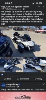

Saw this on Facebook.
Yeah I just tried on mine too, nothing. I have headset paired by BT, phone paired by BT, phone connected by USB but no CarPlay icon on the screen. It shows it on the little hang tag with an "Android Auto not yet available" in fine print.
