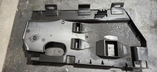

I bought a brand new 2023 RTL last month, and just returned home from riding it for the first time in Florida for a total of three days and almost 1200 miles. Not a single issue with the bike, except I would get a faint smell of burning engine oil from time to time. I checked the oil every day, and it was completely full (over full actually). In addition, there were no visible leaks, or oil spots under the bike in the morning. I finally wrote it off as the new, hot oily smell that new vehicles have.

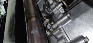

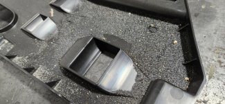

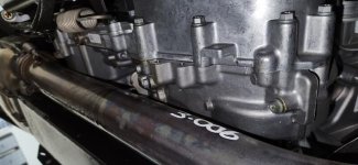

I warmed up the bike this evening for its first oil change, and the hot oily smell came back. It even made some light smoke. I placed the bike on car ramps, removed a plastic cover under the engine, and noticed the engine/ trans was oily. That oil in turn had been dripping on the exhaust pipe, which identified the hot oily smell.
Before I get upset and call my dealer, I have some questions for you guys:

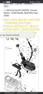

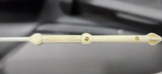

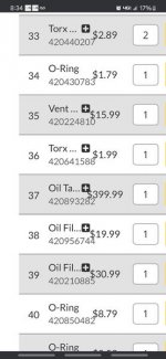

Is it possible for the engine to puke excess oil in a over-fill scenario? This bike has too much oil in it. The picture doesn't do justice, but the oil level is up past the plastic indicator and on the cable even. Is there a breather up high that could be puking oil?
I checked the drain plugs, and they're tight, so I know oil isn't seeping from them.
Is there anywhere else I should look and inspect?
Has anyone else with a '20+ RTL had this happen? It's not a horrible leak, but it needs attention. I'm just trying to identify something obvious before I make the call. I'm reluctant to go ahead and change the oil and/ or put a wrench to it out of fear that it may compromise the warranty.
