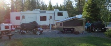

Like others have said here, it's the stopping issue not the pulling issue , just pay attention to the 40/400 rule and you will not have problems, the down hill cornering issue is something to REALLY pay attention to . My wife and I both pull trailers and with a combined mileage of near 100K we have kept them both on the road. Pulling the pop up gives us the option of camping or finding a motel if the weather turns bad. On our extended trips we camp a few days then find a room for a night and it helps stretch the travel budget. And we have made some great new friends at some campgrounds that share the same interest in riding and camping.
